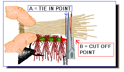

1) Holding elk hair with left fingers, align hair along shank so that tips extend back of hook shank about 1/3 hook shank length. This length will vary according to personal taste and style. Note tie in point at hook eye and cut off point about about hook eye length. |
2) During this process, you may want to grip hair closer to hair butts so that just the area between tie in and cut off is extended past finger tips. In illustration, I grip near hair tips for visual clarity. Cut excess hair. |
3) Should look like this with butts trimmed evenly. |
